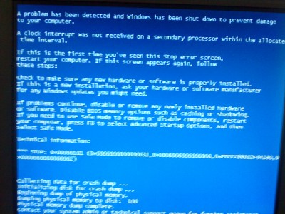

Jak bych se vyjádřil ? Asi takhle: Hra Call of Duty Modern Warfare 3 mi po instalace Frameworku 4.0 vyhazuje modrou obrazovku, kterou uvidíte na screenu.

Tady je ta chyba při spuštění MW 3

Zkus tohle
http://www.resplendence.com/whocrashed
Nainstaluj to, spusť, klikni na analyze a pak zascrolluj dolů až uvidíš nadpis "crash dump" tak sem hoď ty výpisy, to by mohlo pomoct určit kde je problém.
Ten program se probere logama co se ukládají když ti něco sejme windows a pak napíše co konkrétně tu chybu vyvolalo, takže se z toho pak dá něco vyvodit.

Tu jsou ty výpisky..
Crash dump directory: C:\Windows\Minidump
Crash dumps are enabled on your computer.
On Mon 4.6.2012 4:33:56 GMT your computer crashed
crash dump file: C:\Windows\Minidump\060412-18220-01.dmp
This was probably caused by the following module: ntoskrnl.exe (nt+0x7F1C0)
Bugcheck code: 0x101 (0x31, 0x0, 0xFFFFF88002F64180, 0x2)
Error: CLOCK_WATCHDOG_TIMEOUT
file path: C:\Windows\system32\ntoskrnl.exe
product: Microsoft® Windows® Operating System
company: Microsoft Corporation
description: NT Kernel & System
Bug check description: This indicates that an expected clock interrupt on a secondary processor, in a multi-processor system, was not received within the allocated interval.
This appears to be a typical software driver bug and is not likely to be caused by a hardware problem. This problem might be caused by a thermal issue.
The crash took place in the Windows kernel. Possibly this problem is caused by another driver which cannot be identified at this time.
crash dump file: C:\Windows\memory.dmp
This was probably caused by the following module: hal.dll (hal!HalReturnToFirmware+0xB2D)
file path: C:\Windows\system32\hal.dll
description: Hardware Abstraction Layer DLL
The crash took place in a standard Microsoft module. Your system configuration may be incorrect. Possibly this problem is caused by another driver on your system which cannot be identified at this time.
On Sun 3.6.2012 20:13:06 GMT your computer crashed
crash dump file: C:\Windows\Minidump\060312-29920-01.dmp
On Sun 3.6.2012 14:30:00 GMT your computer crashed
crash dump file: C:\Windows\Minidump\060312-22432-01.dmp
This was probably caused by the following module: ntoskrnl.exe (nt+0x4B09BC)
Bugcheck code: 0x124 (0x0, 0xFFFFFA8005A058F8, 0x0, 0x0)
Error: WHEA_UNCORRECTABLE_ERROR
Bug check description: This bug check indicates that a fatal hardware error has occurred. This bug check uses the error data that is provided by the Windows Hardware Error Architecture (WHEA).
This is likely to be caused by a hardware problem problem. This problem might be caused by a thermal issue.
On Sat 2.6.2012 18:58:45 GMT your computer crashed
crash dump file: C:\Windows\Minidump\060212-46176-01.dmp
Bugcheck code: 0x124 (0x0, 0xFFFFFA800459E8F8, 0x0, 0x0)

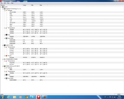

Stáhni si HW monitor a dej sem screen s teplotama, nejlépe v zátěži
Re: Většina her na steamu mi padá nebo způsobuje BSOD*
Napsal: 04 čer 2012 18:46
od FastyTV
Tady jsou ty teploty při zátěži ( snažil jsem se při hře Diablo 3 )
Napsal: 04 čer 2012 18:51
od Shorty
Mám tu grafiku taky a při max. zátěži, když hraji i půl dne mám max. 60°C - mám klasický airflow.
Zdá se mi, že ta teplota je trošku hodně, ale nejsem si jist jestli je to tím, počkej na experty :)

Napsal: 04 čer 2012 19:34
od Orcus
83°C je moc. Nic neopravuj a začni chladit.
Napsal: 04 čer 2012 20:01
od FastyTV
A je k tomu nějaké chlazení ? Kdyby ano, šlo by se koupit .. není problém.
A chcete tím naznačit, že je to přehřátou grafickou kartou ?
Napsal: 04 čer 2012 20:55
od Shorty
Jestli nemáš v case dostatečný airflow -aspoň větřák ve předu a vzadu volné místo z PCI slotu, tak to hoď nejprv tam. Pak se podiv a na teploty a když tak kup chladič.
